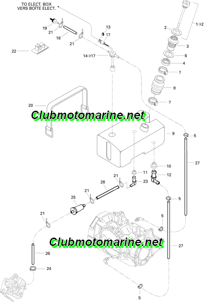

Tient je tes trouver un schématique du système d'injection d'huile  d'un XP 1996 car avant 1996 je trouve rien cela peu aider ton mécano surrement
1275000081Oil Gauge Ass'y. Includes 1 to 21
2293250025O-Ring1
3275000064Filler Neck1
4211100013Nut-Neck Oil Filler1
5293650038Tridon Clamp4
6293250016Gasket1
7293650035Tridon Clamp2
8275000070Filler Hose Neck1
9275000123Oil Tank1
10293720002Grommet1
11570135100Grommet1
12293710002Elbow Fitting 90°1
13293550004Dielectric Grease, 150 G1
14278000478Oil Level Senser Ass'y. Includes 14 to 171
15278000218Wire Seal2
16278000222Male Terminal2
17278000217Female Connector, 2 Circuits1
18275500018Hose 6 mm1
19275500087Check Valve1
20293850022Strap1
21293750001Tie-Rap 94 mm5
22293750005Tie–Clamp1
23293710003Elbow Fitting 90°1
24293650042Oetiker Clamp1
25275000051Oil Filter1
26275000007Hose 8 mm1
27275000008Hose 12 mm (Meter)1
